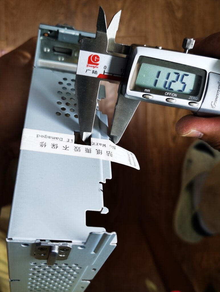

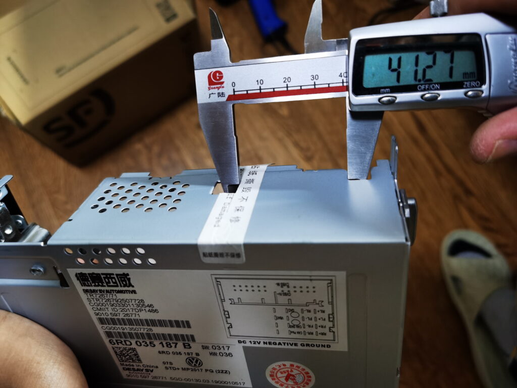

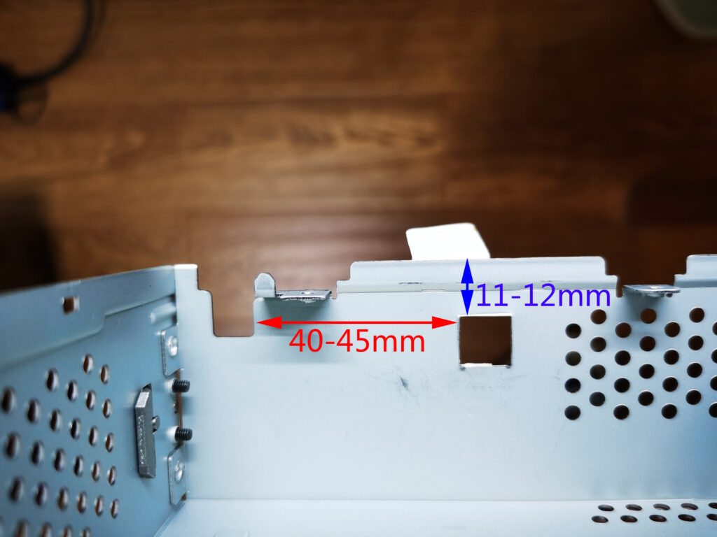

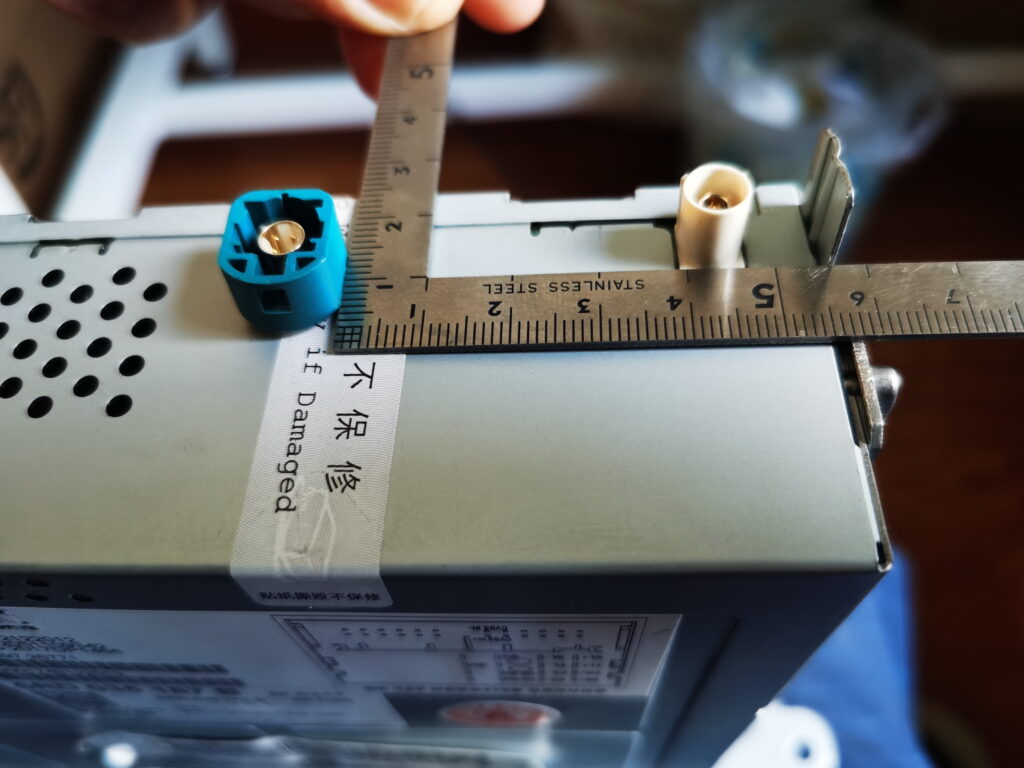

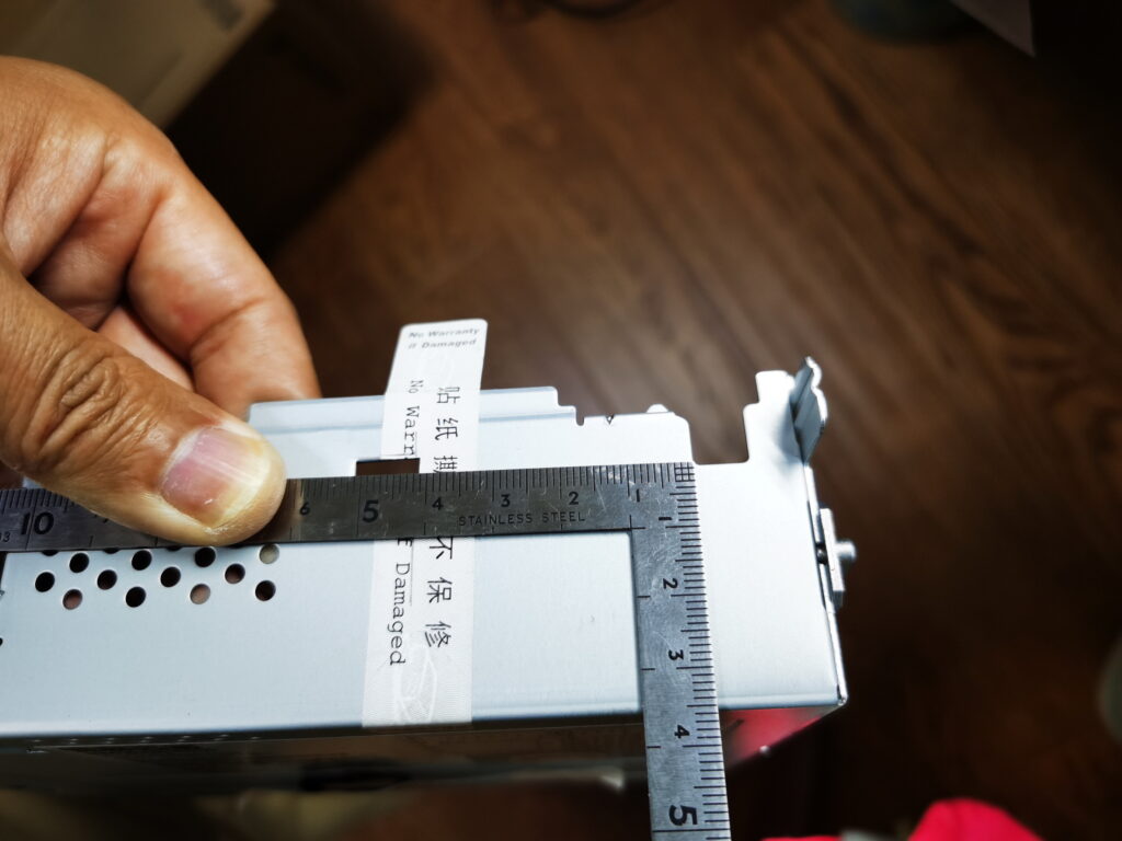

The original position of the USB interface of the RCD330 PLUS is at the front of the panel. In order to make it more beautiful. We hide the cell phone cable at the rear of the unit.
In addition, some Volkswagen such as Jetta, Golf, Passat, EOS, Beetle, etc. The original installation location of the USB is more reasonable. We can make RCD330 PLUS use these USB original installation location.
