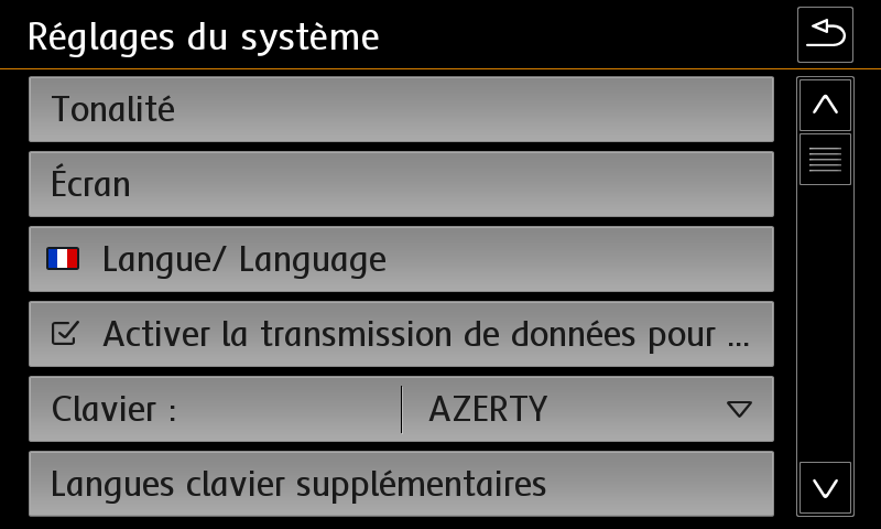

Quote from Ddren on September 12, 2026, 7:15 amBonjour à tous! / Hi everyone,

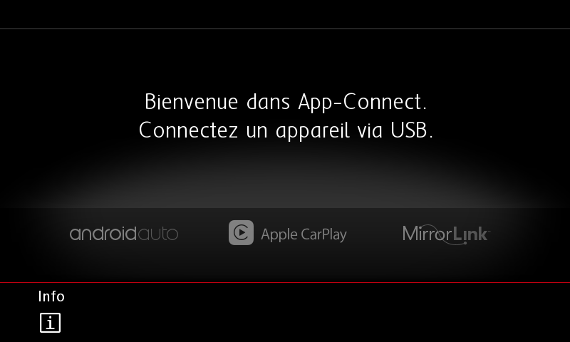

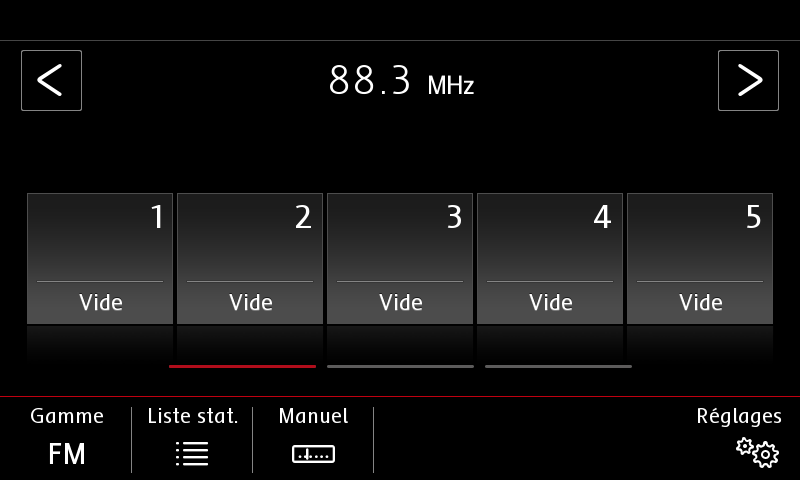

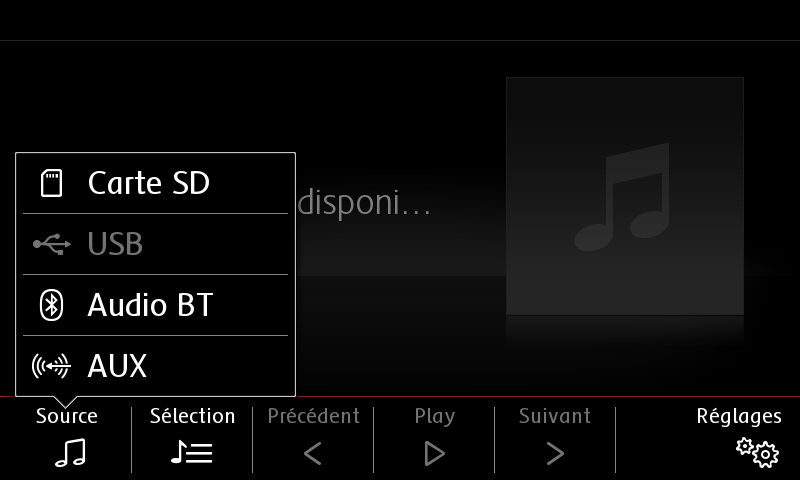

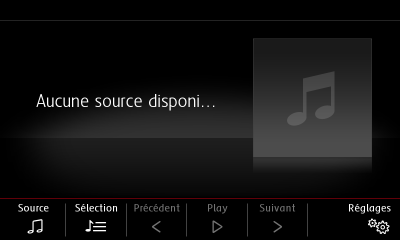

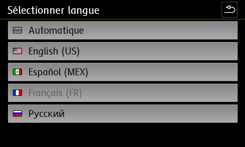

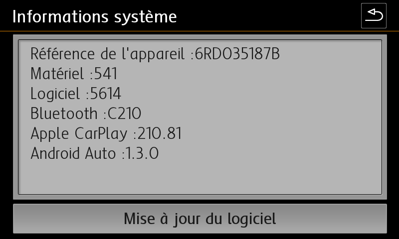

I have developed a custom French (Français) firmware for the RCD330 Noname 187B head unit.
Supported Hardware: Noname RCD330 / 187B ONLY (Do not flash on Desay or 187A units!)
Added Language: French (Français)
System Version: 5614
Key Features: Full UI translation, Bluetooth / Apple CarPlay / Android Auto support.
USB Drive: Use a USB flash drive (32GB or smaller) formatted in FAT32.
Power Stability: Ensure your car battery is stable during flashing. DO NOT turn off the ignition or disconnect power while updating!
Disclaimer: You are flashing this firmware at your own risk.
Firmware File: [spoiler title=""]Download[/spoiler]
Feel free to test it out and leave your feedback or bug reports below! Enjoy!

Quote from golf 6 on September 12, 2026, 1:53 pmSalut c'est possible de faire une mis à jour sur mon rcd330 187b Device part number:6RDO35187B
Hardware:534
Software:5815
Bluetooth:C180
Apple CarPlay:210.81
Android Auto:1.3.0
