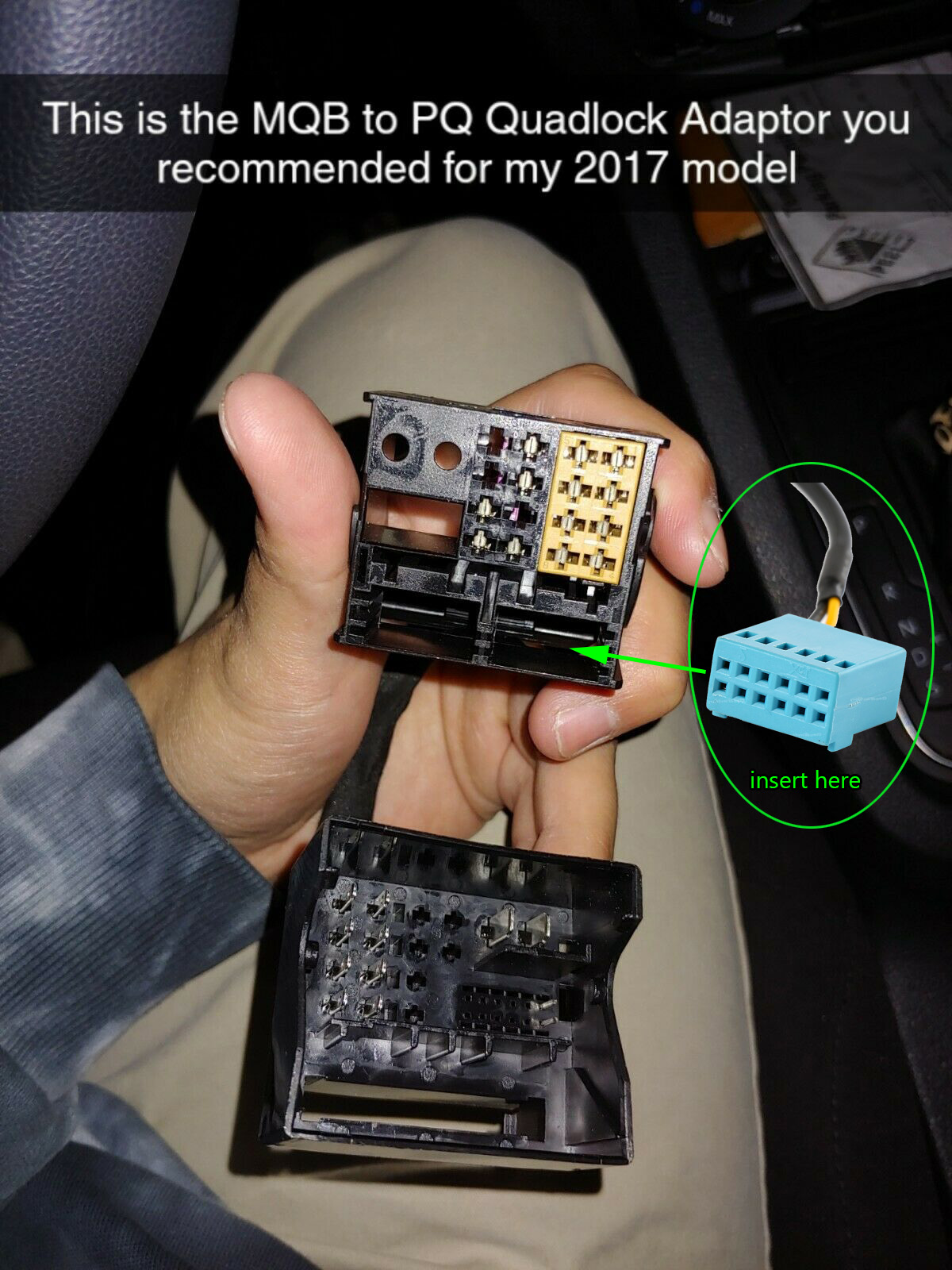

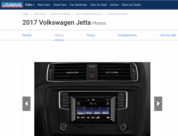

3. How to install back-up camera for 2017 Jetta
RCD330G PLUS can replace this head unit to work. You need a conversion adapter for MQB TO PQ.
https://www.ebay.com/itm/184099392973
3, Delay box needs to be connected to the positive of the reversing light. GND wire must be connected.
