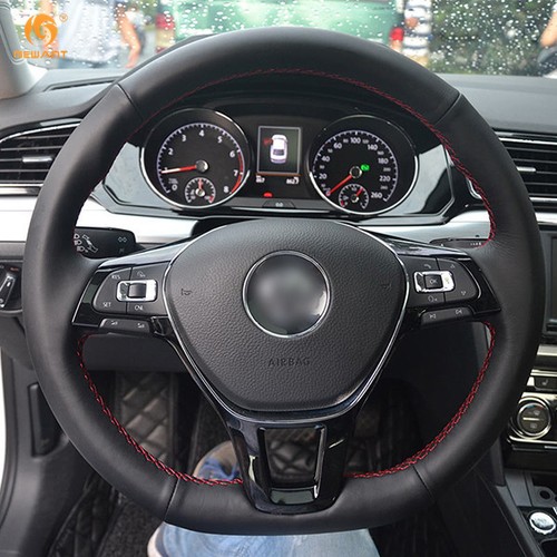

  4. Will my steering wheel buttons work? My steering wheel looks like the one in this picture:
(link to steering wheel picture: https://i.ebayimg.com/images/g/ib0AAOSwmVBZgYE-/s-l500.jpg)

  4. Yes. Your multi-function steering wheel can directly control RCD330 plus.
