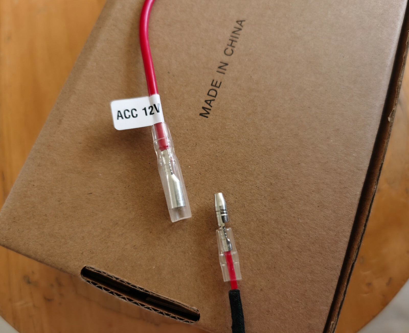

Quote from Ddren on September 21, 2019, 1:57 pm1. ACC 12V+
2, the positive of reverse light
3. Ground wire.Finally, you must install the inner cover of the trunk and close the trunk. There is a sensor on the trunk. If you don’t close the trunk, the camera will also have a black screen.
Note: that the No. 5 and No. 6 fuse terminals are small, No. 42 is medium.

1. ACC 12V+
3. Ground wire.
