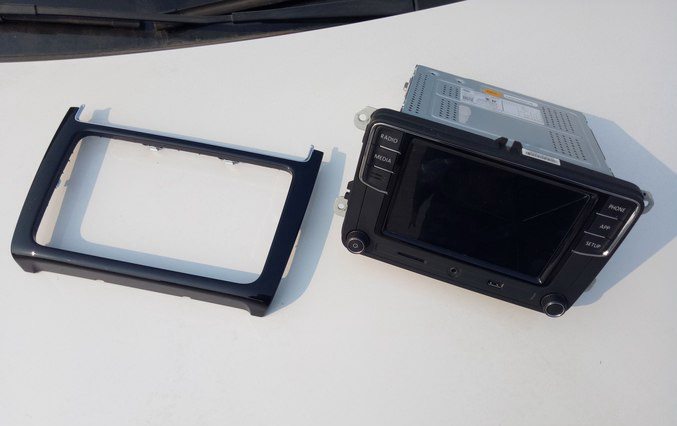

Quote from Ddren on October 4, 2019, 1:46 pm2018 Polo with RCD330g Plus noname. (PQ 25)
RCD330g plus works well with the original MFSW steering wheel. If your Volkswagen polo offers a rear parking sensor with audio feedback, it will be able to offer OPS (Optical Parking System) on the head unit.
This feature is quite useful but lack of camera in the older variants warranted some kind of visual feedback. This function can be supplemented with visual feedback if we have head unit supporting OPS (Optical Parking System).
Amount of work required to retrofit OPS in your vehicle would depend on following
- You have rear parking sensors in your vehicle.
- You have head unit supporting OPS.
- You have parking module supporting OPS /4K OPS or 8K OPS.
In older variants of Polo with 4K OPS module or 8K OPS module was present, so, if they replace existing head unit with RCD 330g they would automatically get OPS display.
