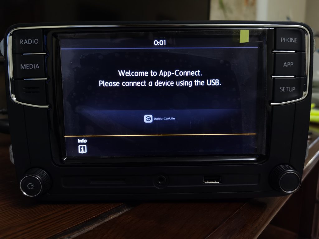

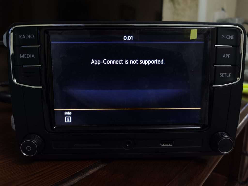

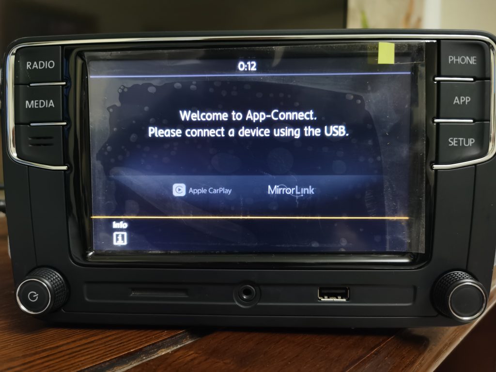

Quote from Ddren on May 7, 2020, 11:29 amSome friends encountered some confusion when using RCD330 PLUS Desay 187B. It cannot activate Carplay, Carlife and Mirrorlink functions correctly. In fact, whether they work depends on their coding. Let me tell you now.
1. Carplay, Carlife and Mirrorlink are all actived. (Byte 0=16)
2.Carplay, Carlife and Mirrorlink are all deactived.(Byte 0=00)
3. Carplay and Mirrorlink are active, and Carlife is deactived. (Byte 0=10)
4. Carplay and Mirrorlink are actived, Carlife is de-actived. (Byte 0=06)
