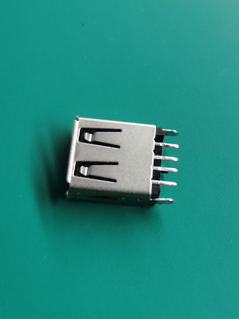

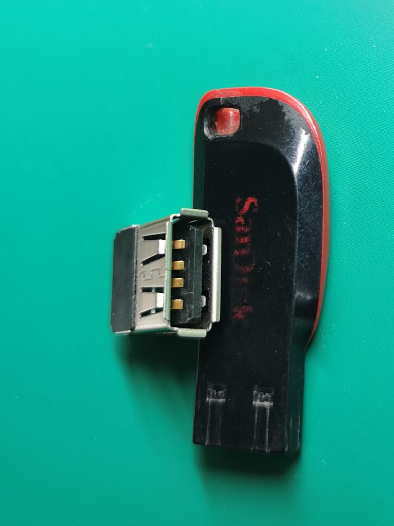

4. It is recommended that you find an obsolete device, remove its USB terminal, and solder it to your motherboard. First of all, you must ensure that the front is working properly, so that it is easier to find out where the fault is.
