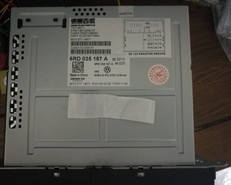

DESAY RCD330 PLUS 6RD 035 187A  support aux, sd card, usb ,rear camera, mp3/wav/flac/ape/ mp4/rmvb etc..
